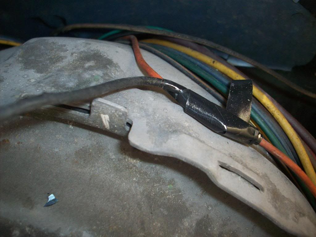

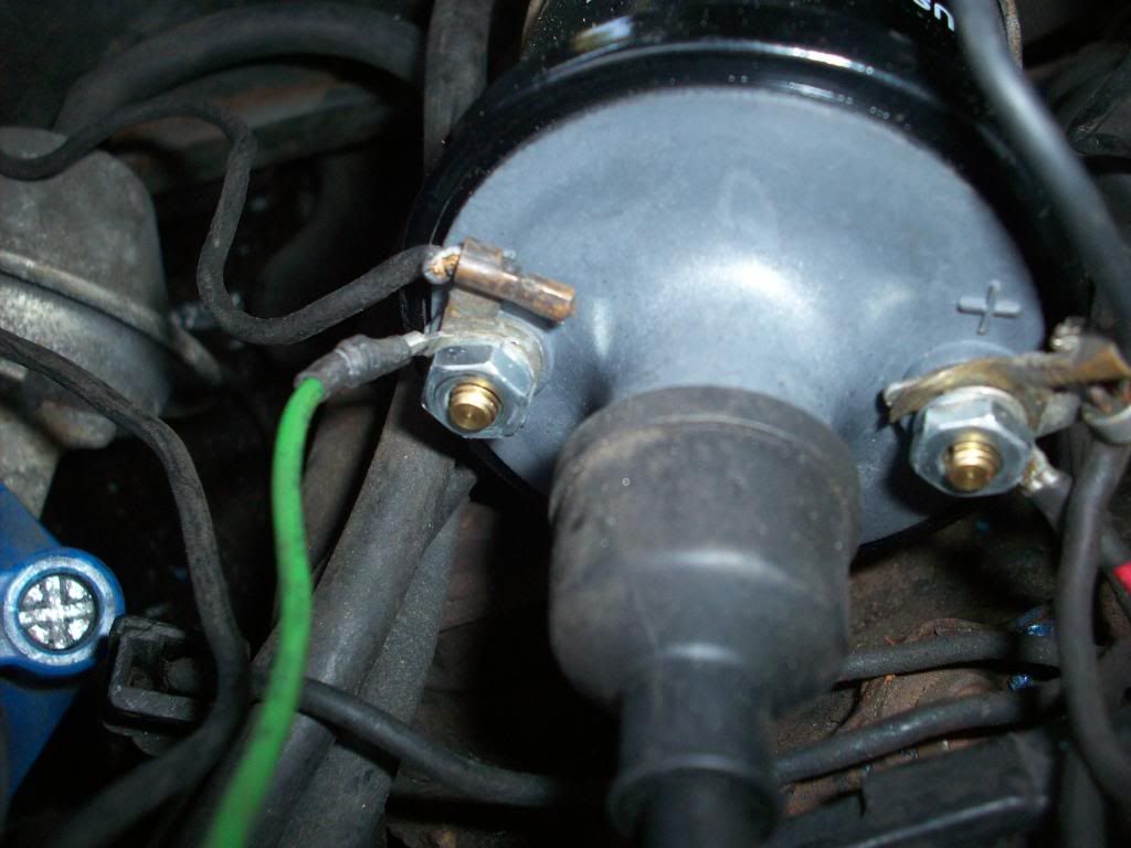

A friend came over yesterday and we checked and there is no spark from the coil to distributor. I have two wires on the positive and two on the negative on the coil. One wire on the positive is spliced into a wire on the firewall, driver side. I don't know who did this, but don't think that's where it's suppose to go. There is no power to the wire with the key on or while turning the key. Here are a couple pictures, don't know if they will help at all.
coil wires
coil wire splice
quick fix. run a jumper wire from the + side of the battery to the + side of the coil see if she fires. don't run it long. but if it does the points and coil are OK. some one has chopped out the resistor wire and spliced IT into one other hot wire. you have been running 12 volts to the coil. bet you'll find there splice has given up or what ever they spliced into has blown a fuse. you need to re do your run wire and I'm till beating you fried the pertronitics. I can dig out the instruction and show were its stated you need the ballast resister but trust me it's there. find the hot wire off he ignition switch. there will be one that is hot when the key is in the run position. run a wire from it to a ballast resister. from there to the coil. you have your run circuit in tack. now you should have 12 volts coming up from the started so that when the key is in start you get the higher voltage to start the car. then when it goes to run you get the reduced voltage to run the car. don't mess with what ever they did just start over . then check the coil and the points. you should be good to go.

On the coil negative - If the green is the wire to the points eliminator, then the black wire must be the old points trigger wire. This wire should be GONE. I'm wondering if perhaps the other end is still inside the distributor - maybe it even had a piece of electric tape which may have fallen off, and is now grounding on the breaker plate? In any event - disconnect it from the coil, and for the sake of neatness, remove it completely.
On the coil positive... in a word? Yikes! it looks as though there is a third spade lug peeking out on there - is that correct? Not sure of the color codes on your year, but in 1970, there would have been a yellow wire, and a white wire with an orange tracer. The yellow is battery voltage for start, the white/or is the ballast resistor feed. The only orange wire in my diagram is for the transmission downshift switch. If you look at the Accel diagrams, not only do they show the ballast resistor in use, they show ONLY the ballast resistor. My advice is as follows: get rid of that funky jumper wire for starters. My guess is that the ballast wire is broken, and that was someone's quick fix. The problem here is that the other wire going to the starter solenoid will only have voltage during cranking... get rid of that as well. Either fix the problem with the ballast resistor, or just run a new wire. On my diagram, the ignition feed is a 12awg Purple wire in cavity DY on the bulkhead connector. That's the second row up, the second cavity from the right. If you go this route, just get yourself a ballast resistor and make sure you put it in series with the wire.

Saturday I was going to put on the Pertronix, I was looking at it and it's for a Ford distributor. So I have to take it back and order the right one. While I was under the hood I found the original resistor wire, both pieces :hide:. One piece goes into the firewall and the other piece is goes to a wire that is connected to the + side of the coil :4_11_9:.

I know why the resister wire was cut. A couple years ago when my hearse wouldn't crank, which was a yearly thing. Every time it was the points. I had my hearse at the mechanic's. He told me he turned on the ignition and he saw a wire smoking. So he cut the wire and hooked it to another wire. I had forgotten about this until recently.
