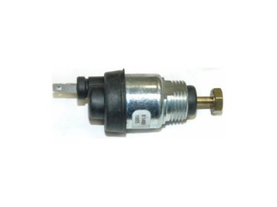

Here is my next partial predicament. Since the original style QJ will be put on I will be reinstalling the Transmission Kickdown Switch and Idle Stop Solenoid. My kickdown switch seems to be in good shape, The arm is good and seems to trigger correctly with an ohm meter when turned to about 60%, I can also hear a "click" at that point!
The Idle Stop Solenoid is another issue. The rear of it with the wire is missing. I will need to find a replacement. I have been scouring the internet not finding an exact match. Nothing whatsoever! Like everyone told me before, some parts are no longer available and you need to improvise. I found one that I think will do the job. It's for an Olds 72-74 It appears the threaded area on this one is shorter and the shaft does not come out of the rear of the solenoid. Aside from shelling out a $325 for a NOS one I haven't see many other options.
I am also a bit confused of its actual function. The 72 shop manual states it as an anti dieseling solenoid. Other places say it is a fast idle solenoid for when the AC is running. Is this more of a jack of all trades switch? Would there be much of an issue If I ran the car without this until I came across a better priced one?
The closest option i have found that isn't $300 +.
They were used for both jobs depending on what the car needed but most were toup the idal with the ac on. The dash pot was used as the antie deseling device.
