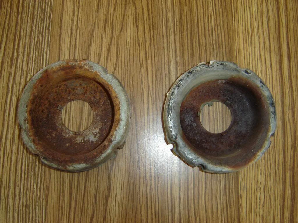

Heres the tail light plates that hold the light sockets....
Before glass beading...

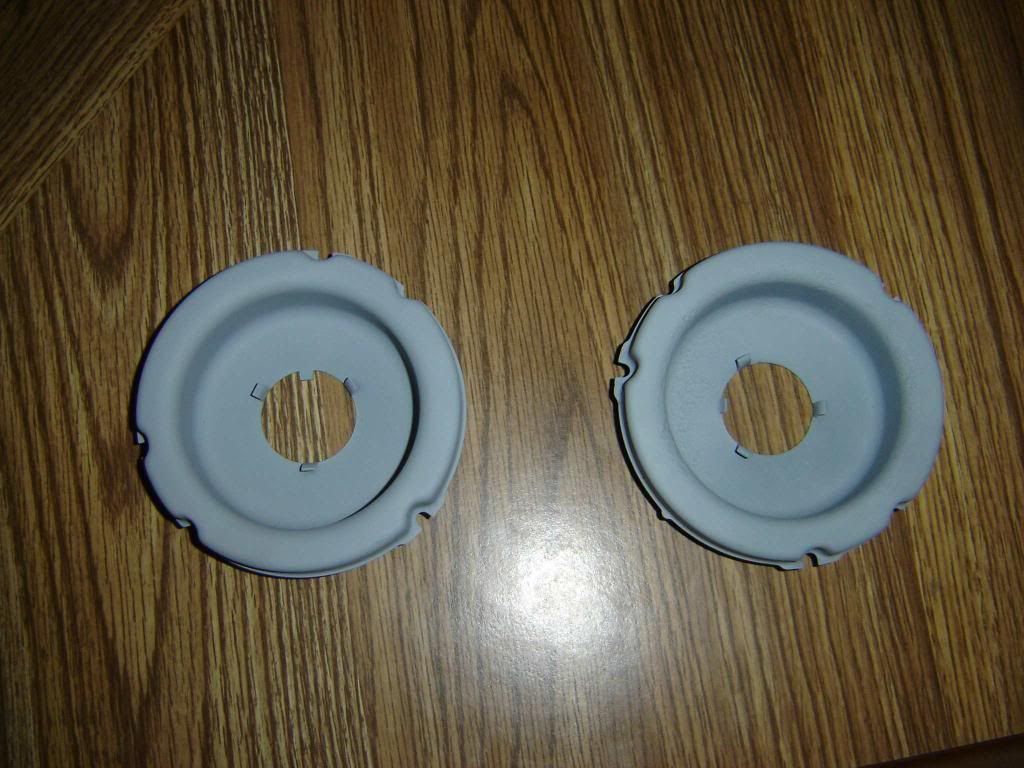

After with a coat of primer...
