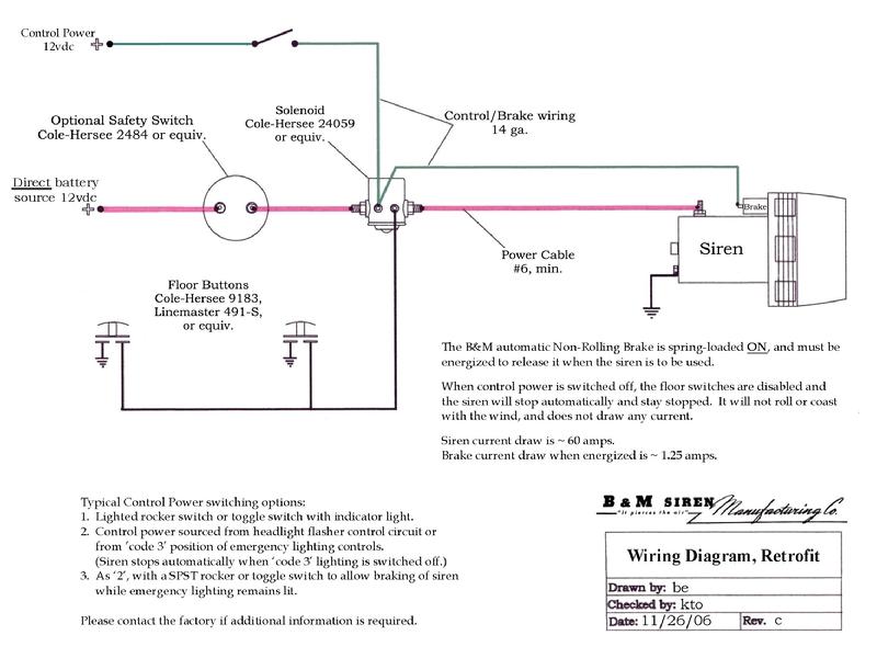

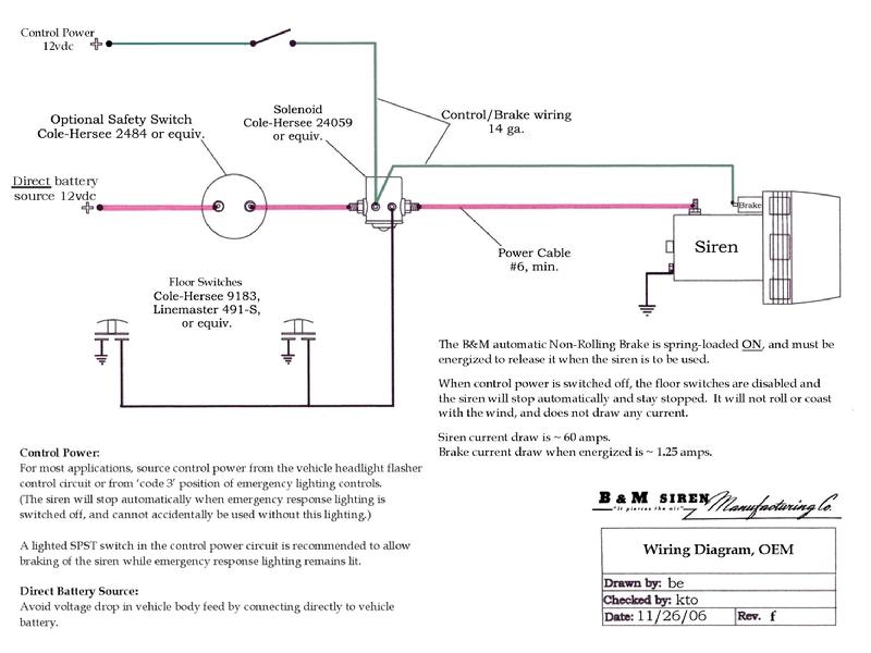

While you're at it, you might want to point out to this person the benefits of fuses and solenoids/relays, and pray they don't run full power to the siren via a wire through an ungrommeted hole in the firewall going to a switch under the dash.
Allow me to once again rip off Kevin O'Connells wonderful B&M siren wiring diagrams:
